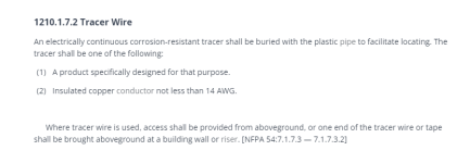

I don’t see a tracer wire either.
I don’t see a requirement for that in the code [see Post #9] but I also agree that it is good practice to have tracer wire wrapped around a gas line in case future ground work is necessary. Good catch.

7.1.7.3 Tracer Wire.
An electrically continuous corrosion resistant tracer shall be buried with the plastic pipe to facilitate locating.
7.1.7.3.1 The tracer shall be one of the following: (1) A product specifically designed for that purpose (2) Insulated copper conductor not less than 14 AWG
7.1.7.3.2 Where tracer wire is used, access shall be provided from aboveground or one end of the tracer wire or tape shall be brought aboveground at a building wall or riser.
1210.1.7.2 Tracer Wire
An electrically continuous corrosion-resistant tracer shall be buried with the plastic pipe to facilitate locating. The tracer shall be one of the following:
A product specifically designed for that purpose.
Insulated copper conductor not less than 14 AWG.
Where tracer wire is used, access shall be provided from aboveground, or one end of the tracer wire or tape shall be brought aboveground at a building wall or riser. [NFPA 54:7.1.7.3 — 7.1.7.3.2]
