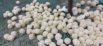

I did castrate my pool filter.
What water was left after draining was dark olive green. The balls themselves ranged from almost as white as they went in at the top of the filter to dark green at the bottom. Interestingly, I found a piece of somnething that I don't recognize as a pool part in the sludge. I'm attaching a couple of pics of the balls to give you an idea of what they came out like. Plus a pic of the part I found. It looks very familiar, but I can't put my finger on what it could have came from. It's not from anything in the filter. I went through all the parts inside and everything looks good.
