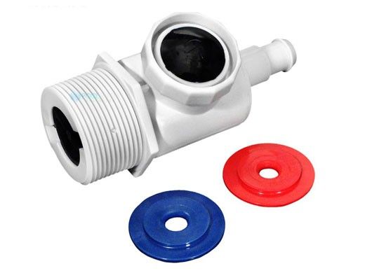

Install the red or blue restrictor disc to reduce the flow.

Install the red disc.
The red disc will provide more restriction, which will reduce the load on the motor by reducing the flow.
The universal wall fitting comes with a blue restrictor installed and an optional red restrictor for use if needed.
These special restrictors are designed to work in combination with the pressure relief valve.
Together they will release excess water pressure so the Polaris can operate at its optimum level of efficiency.
The red restrictor provides maximum water restriction, while the blue restrictor provides less restriction.
