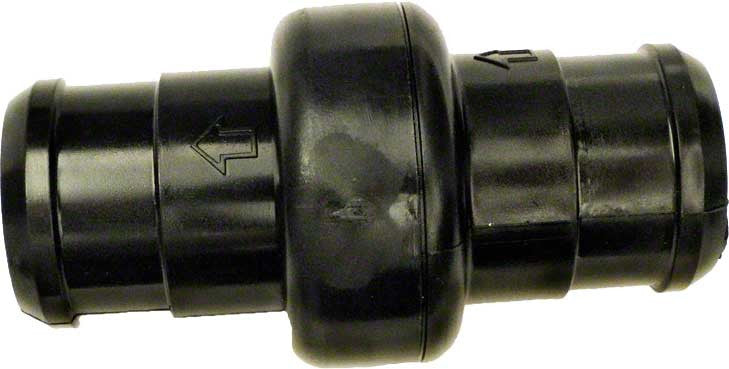

I have a Polaris 360 and it has not been moving fast in the pool. I did notice a leak in the hose and was curious if that was caused by a broken O-ring and if that would slow down the cleaner. I have attached a photo and any feedback would be greatly appreciated.

Hey, I would make sure the hose nut is fully threaded onto the hose and if the O-ring is bad maybe just replace the whole hose nut before buying a swivel. Swivels when bad normally break at that middle seam, but obviously anything is possible :paddle:
Leaking swivel. In the picture you can see the water coming from the swivel onto and around the nut. Replace it.
Take it apart and take a close look at where it is leaking.
