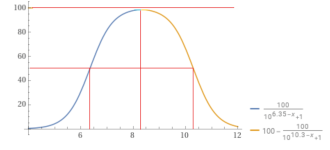

Percentage bicarbonate.
_____________________________________________________________________________________
Bicarbonate vs. carbonate.
Carbon dioxide vs. Bicarbonate.
You can use the formulas to calculate the percentage of bicarbonate vs. carbon dioxide or carbon dioxide vs. bicarbonate.
100÷(1+10^(6.35 – 8.3)) = 98.890% bicarbonate vs. carbon dioxide.
100-(100÷(1+10^(6.35 – 8.3))) = 1.109% carbon dioxide vs. bicarbonate.
