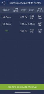

Can someone help me understand the best way to set up my schedule when I want to keep the heatpump running 24 hours?
Currently my pool pump runs 6am to 10pm. If I want to run the heatpump overnight I thought I could use an egg timer and set the pump to “do not stop” but that doesn’t seem to work so I’m going into my schedule and changing it to run from 6am to 6 am and then changing it back when I don’t want it the heatpump to run 24 hours
It’s running of an easytouch PSL4 and there are 3 pump schedules set. basically a higher pump setting for 2 hours am and pm and then a lower setting for the rest of the day. I believe it can only run 4 schedules and the egg timer would count as one but it still shut off on schedule last night with the egg timer set to “do not turn off”

L,
Just so that we are both on the same page...
An egg-timer is used to automatically shut off something that is manually turned on. So you turn on X circuit, then the circuit will turn off when the egg-timer times out. If you have the egg timer set to do not stop, if you turn on something manually it should just stay on forever.
You EasyTouch Lite only have 4 total schedules and this includes any egg-timers or run-once programs. If you have ScreenLogic, it will let you enter 50 billions schedules, but on 4 will work.
To run a schedule 24/7, you set your time to 8 am until 8 am.. I suspect that 6 am until 6 am would be the same, but I have never tried it.

Ok thanks. I don’t normally need to run my pump 24/7 so I was looking for a quick way to override my 14 hour schedule to 24 hour easily. But if changing the schedule times is the best way I’ll continue to do it that way.
