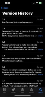

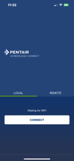

Hi everyone,
Not sure if this is the correct forum location. The iOS Pentair app (ScreenLogic Connect) updated today from v7.5 to v7.6 and now it does not connect to the panel (app just says "Waiting for WiFi"). Thankfully we have a 2nd iPhone in the house that hasn't updated the app and it connects just fine.
This app hasn't been updated in ages so I was hopeful Pentair may have actually added some improvements. I guess I was wrong.
Anyone else experience this?
Tony

Yeah, one of those was me. Tried resetting the protocol adapter (3 quick presses of the reset switch) which is what usually gets me back online, but not this time. I can connect using remote, using the PC app, and using the CONFIG tool, but not using local on the CONNECT app on iPhone or iPad.

I'm glad I found this thread - i've been troubleshooting this off and on for a few days thinking I had a new issue and rebooting everything didn't help.
I did see the upgrade to 7.7 in my Apple Store and upgraded, but it's still "Waiting for WIFI" indefinitely. Anyone else still stuck?
v7.7 fixed the issue for me. You may have tried this already, but I would fully restart all your gear that is in play - Pentair panel, router, and even your phone.
