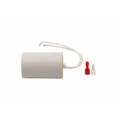

Hello, Pentair told me this is obsolete and I cannot find it on google anywhere, all sites are out of stock/not longer available. Does anyone know what could be a replacement, the number is ZBR39350 from Pentair website but as my capacitor melted I cannot see the spec on it to find my own, any help appreciated on a replacement as I do not want to buy a new pump when it is the capacitor I need. Thanks.
Maybe a 20 uF run capacitor.
UPC #: 788379863487
Maybe 12.5 uF?
Boost-Rite Booster Pump Capacitor 12.5uF 450V S4P1100M
ZBR20360 Item 2- Capacitor 12.5uF S4P100M 450V
  • Love
Reactions: PoolStored
UPC #: 788379863487
Maybe 12.5 uF?
Would this be a replacement ZBR20360 for the ZBR39350 ? My capacitor has a 45 on it not a 20, is that important ?
Please note that Icar has ceased manufacturing and some capacitors has been replaced by the new Ducati brand. Please contact us for availability.
As best as I can tell, a 45 uF Run Capacitor should work.
However, I cannot tell you with 100% certainty that a different product will work for your pump.
Also, there might be other issues with your motor beyond just a bad capacitor.
Thanks, the motor is buzzing but not turning and when I looked at the capacitor it looked like it basically melted... I will try one and see if it works, thank you for your help on this one.
Reactions: JamesW
