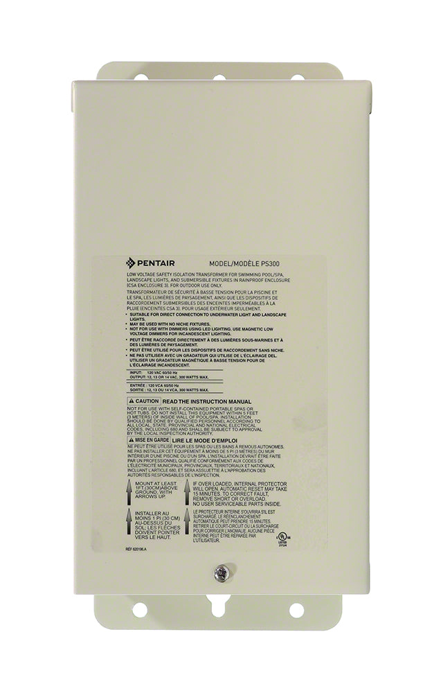

Could you point me to some pool rated transformers?

I did end up purchasing one of these lights. I also ID'd a transformer, and the light was already 12v power, so it should be a pretty easy swap assuming I can pull 100' of cord through the conduit successfully. I'll update when it's done.
