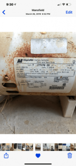

Hi, I need to replace my Whisperflo WF-28, 2HP pump, I like to upgrade to a VS pump,
Does the power of Pentair SuperFlo VS 1.5HP, match my current pool? because I understand the THP of Pentair SuperFlo VS is 2, am I right?
if not do I need more than 1.5 hp from a pump?
I have 20k inground pool with the waterfall which I am rarely using waterfall.
I have Cartridge filters.
no other attachment, just a booster pump which needs to be replaced as well(they both died)
Thank you very much.

You could go with the Pentair IntelliFlo VS or VSF pump. it is 3HP. That is what I did when I replaced my Pentair single speed pump like yours. My VSP model was 011056.
It works great. I run it 20-23 hrs a day depending on time of year. You can set it to run at a lower speed for most of the day and only run at higher speeds when you want to have skimming or your pool cleaner goes on or if you want to run your waterfall.

Thank you for your response, I was very busy and couldn't get back to you sooner, I already ordered a Pentair IntelliFlo VS 011028, I was trying to find out if I don't need more than 1.5 HP so I can go with the cheaper option which is SuperFlo VS 1.5HP although I still don't know or confuse about the Total HP of the SuperFlo VS pump is 1.5 or 2.2!

With regard to VS pump, the Hp rating is at maximum speed - like it would be for a single speed pump. The 011028 is a great pump. When you run it at a lower speed then the Hp is lower and that is where the energy efficiency is best. So going with a higher Hp pump is not an issue if you run it at lower speeds majority of time.
