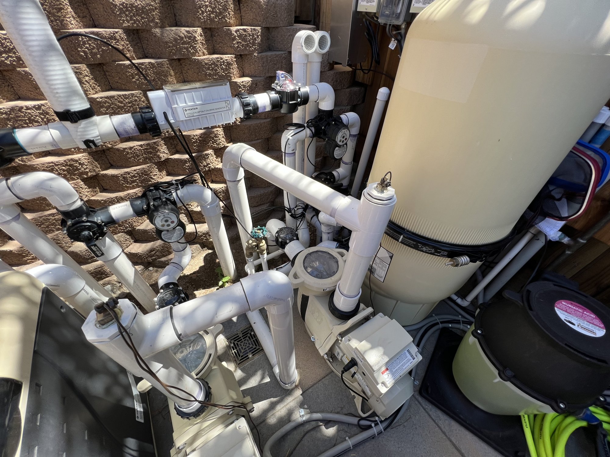

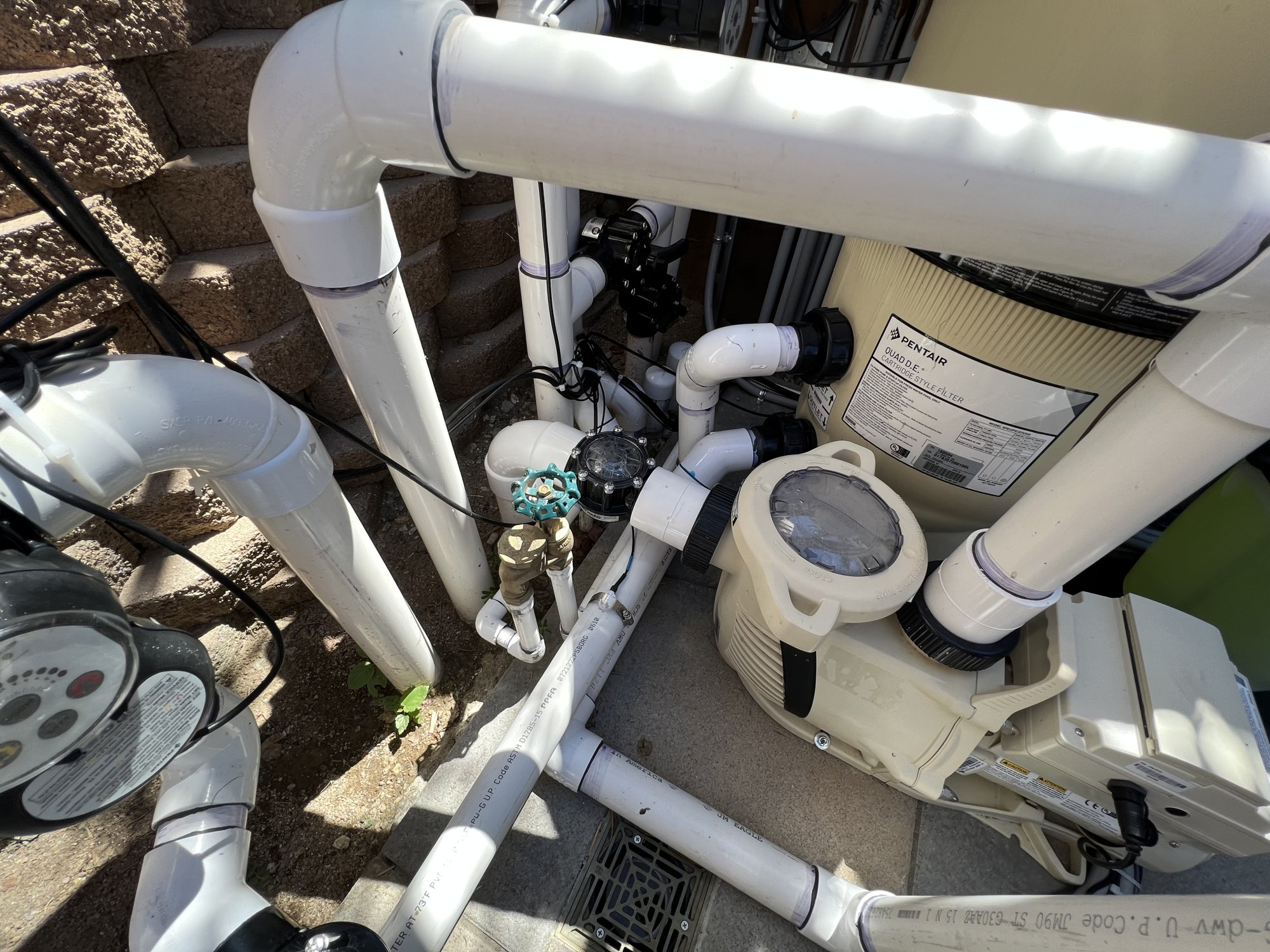

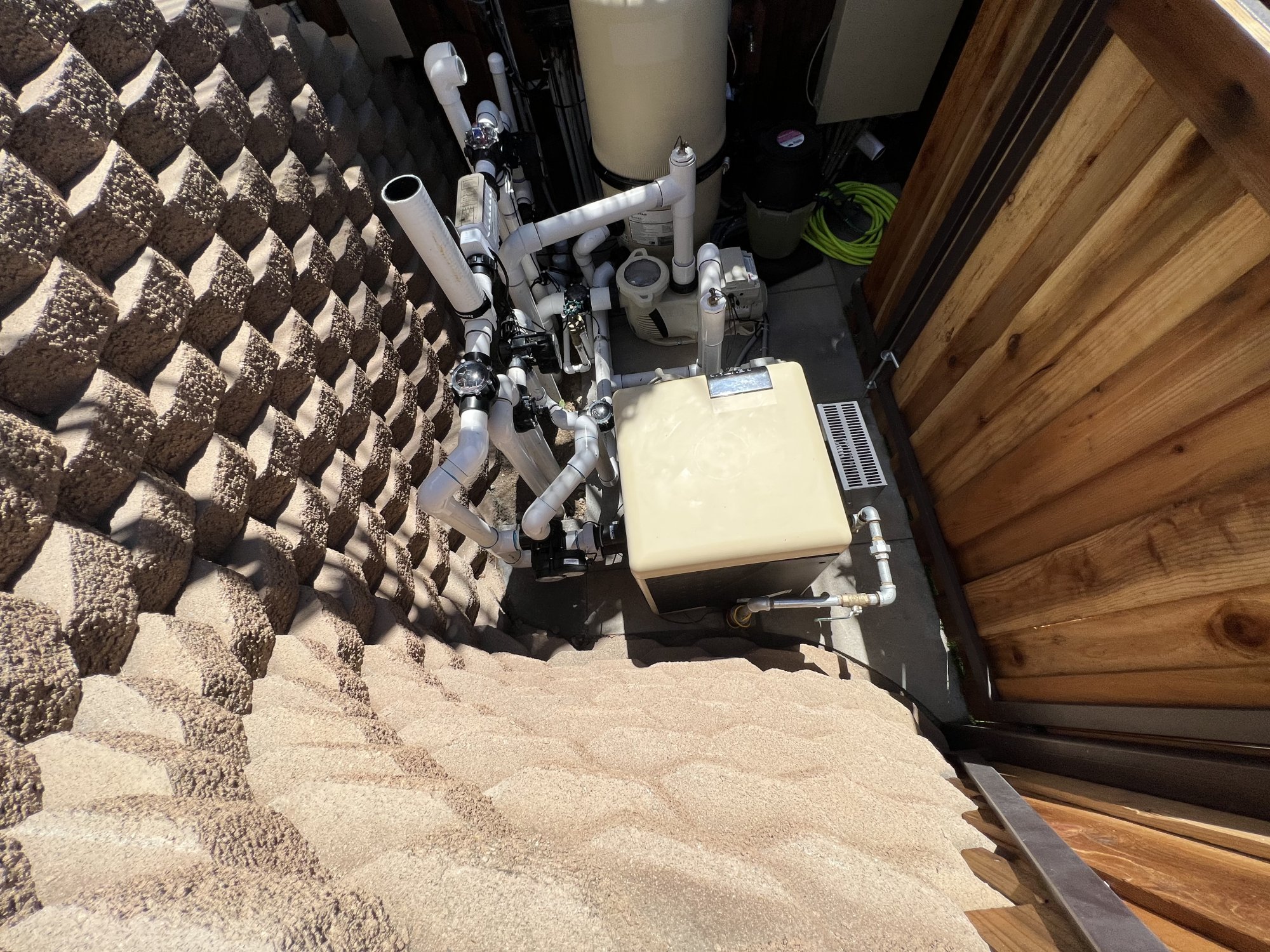

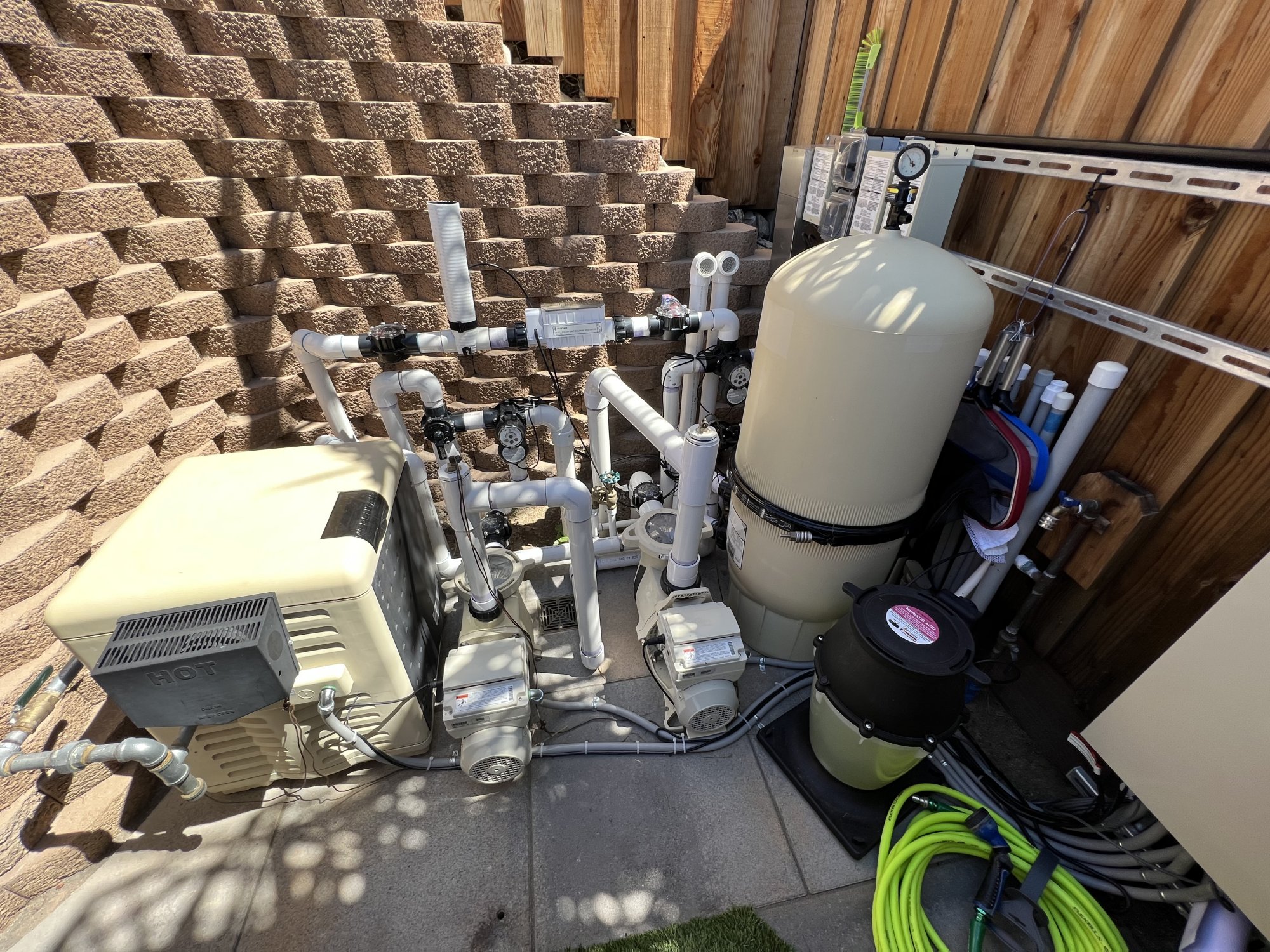

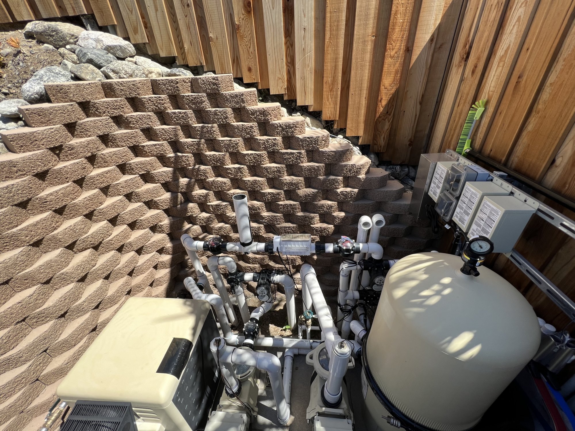

Show us your equipment pad, your autofill line and any details about your home if it’s possible to install a whole house system.
@JoyfulNoise - Based on our current setup I will need to install at the pad area... whole house isn't an option given the only main line is part of our irrigation mainline.
Some pictures of the pad area..
- Copper pipe on the right side has a threaded tee ... pvc goes from that down to the anti-sphion valve to fill.... area is tight but can try to get creative.
For an automated water softener you need a drain line into the sanitary waste sewer. When a softener regenerates, it creates a brine solution that is used to displace all of the retained calcium in the exchange resin. The brine solution gets flushed out by several rinse/baskwash steps. So there needs to be a place for all that water to go and it can't spill out on to the ground as the brine is nearly a fully concentrated NaCl solution. There are softeners designed for outdoor use but they are a bit more expensive. A drain line is a must and it cannot be hard plumbed - it has to be a gravity drain into the sewer with a P-trap.
You might look into locating the softener wherever the nearest sewer connection is and then run the water source to and from that location.
