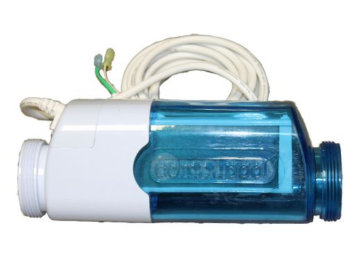

I also, am replacing a Jandy old square salt cell with a new 3 port cell. My aquapure 1400 system has the old square box where the sensor and
DC cord attach. My question is, will my new sensor, which has its own interface module, work with my old system? If so, does it connect where the old sensor is plugged in? Also, the new DC cord has only 2 wires red and blue. I read where the green = red and the blu/blk = blk wht. Does the single Blue wire connect to the + terminal like the old Blk/wht or newer blu/blk/

Red goes to green and blue goes to black/white.
The sensor connects to the same spot. If there's a little adapter card between the old sensor cord and the circuit board, remove the adapter card.
Look at the label on the CPU for the firmware revision.
If the power interface board firmware is
02110A10 or 01220A15, you use program A for the trisensor. All other firmware uses program B on the trisensor inline module.
