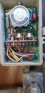

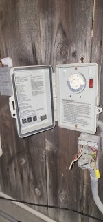

I have an old GE timer. When i open it, it shows 4 different model #s, not sure which is mine, but here's some pictures of it.
Yes, i ran a whole new 220v 80' to the pad. I have two existing 110 circuits at the pad I was going to try to keep the timer on, but as the first commenter mentioned, i can (should) just move the timer and salt cell to the new 220 circuit which solves my problem.
The new 220v, is 4 strands (2 hots, neutral, ground) of 8 gauge. No breaker is on it yet, electrician had to order one.

It appears that the timer can be set for 110v or 220v - look to the left of the blue dip switches on the left side above the white wires. Those dip switches need to be set for the voltage you want the timer (and SWG) to run on.
Your electrician should rewire the timer and set the dip switches to use 220v. And you will also have to have him set the SWG to use 220v (if the SWG supports it).
Additionally, all of those cut off wires in the first two pics need to have wire nuts on the ends - whether or not they are hot. Safety first!
So - FIRST, have electrician check if the SWG can be set to run on 220v. If it can, then have him rewire the timer to use 220v as well. If the SWG can only run on 110v, you will have to use the existing 110v circuit to run the timer and SWG - or have a subpanel installed at the pad, have 220v run to the pump and 110v run to the timer/SWG.

And thanks for calling out those wires! they will be removed/replaced come Wednesday this week (so says the electrician) but i went ahead and put caps on them anyway.
