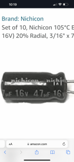

Is there any other righting on it? As mentioned you are looking for the volts and μF the only thing I can tell about them is that they are rated for high temps. Can you take a picture of those locations underneath the PCB. The caps should be marked as the picture below.(example)
