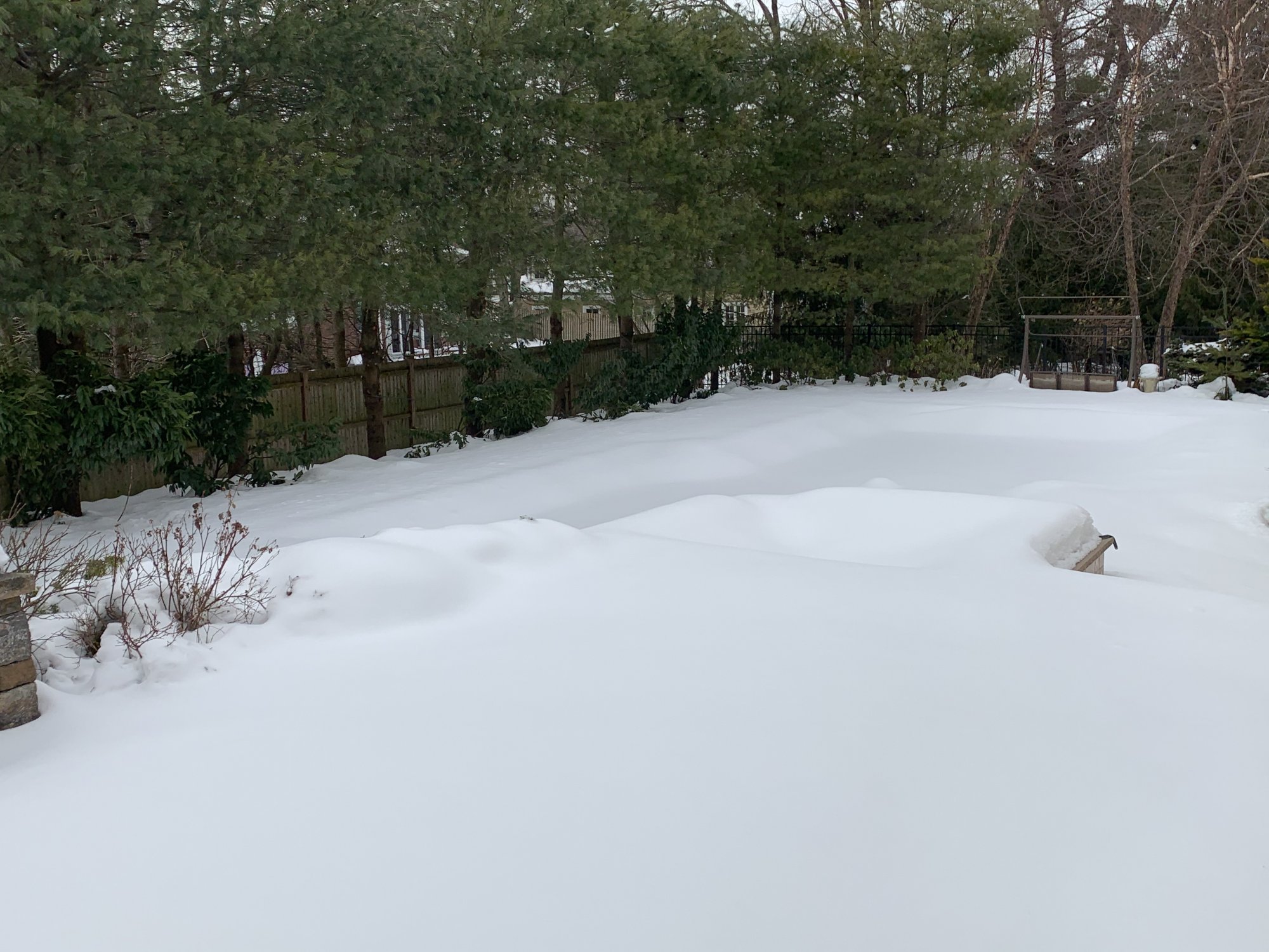

Winter 2024 was exceptionally warm and raining rather then snow. It depends if you believe that is the new normal for NJ winters from climate change or believe in mean reversion and NJ will have colder snowey winters in the coming years. You never know until January and February which way it is going.
Here is the way my NJ pool looked a few years ago…
+1. I got a brand spanky new snowblower a couple years ago but it's officially not new anymore so the harsh winters will be back eventually. :ROFLMAO:
