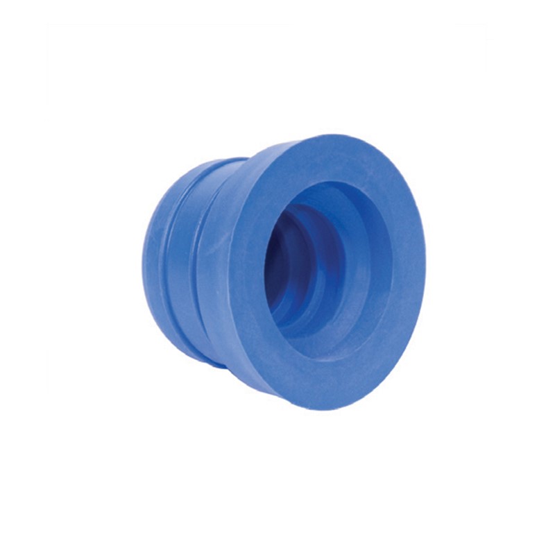

Check for play at the deck connectors. The ladder should be plenty firm if it's bolted down correctly.
+1 on rubber feet, immediately.
