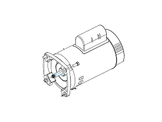

PENTAIR 355204S MOTOR BLK SQFL 1.5HP F 3PH E 208/230V
Nameplate Specifications​
Phase:3Output HP:1 Hp
Output KW:0.75 kWVoltage:208-230/460 V
Speed:3450 rpmService Factor:1.65
Frame:48YEnclosure:Open Drip Proof
Thermal Protection:No ProtectionAmbient Temperature:50 °C
Frequency:60 HzCurrent:4.7/2.35 A
Duty:ContinuousInsulation Class:B
UL:RecognizedCSA:Y
Technical Specifications​
Electrical Type:PolyphasePoles:2
Rotation:Counterclockwise Pump EndMounting:Square Flange
Motor Orientation:HorizontalDrive End Bearing:BALL
Opp Drive End Bearing:BALLFrame Material:Rolled Steel
Shaft Type:1/2 THREADSOverall Length:11.57 in
Frame Length:7.69 inShaft Diameter:0.625 in
Shaft Extension:0.906 in
General Specifications​
UPC:786674029270Weight:23.00 LB
Packaged Length:16.00 INPackaged Width:9.50 IN
Packaged Height:9.50 INHTC:8501.52.4000
Country of Origin:China

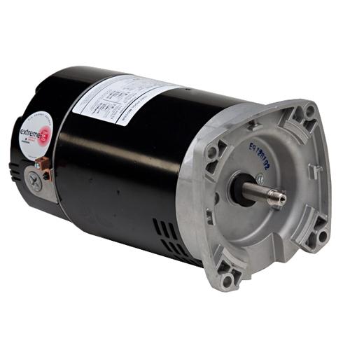

You can use part number 354808S.
The main things that need to match are:
Total HP = 2.2.
Frame = Square Flange.
Phase = 3 phase.
Volts = 460?
Speed = 3,450 RPM.
Frequency = 60Hz.
The motor was made by Kinetek Inc. which is now owned by Nidec.
Price: $454.00
#354808S Pentair WhisperFlo Energy Efficient WFK-6 Motor, 1.5HP, 3 phase, Single Speed, Square Flange, Black
Genuine WFK-6 OEM replacement for pump 011569
208V//230V-460V
Square Flange Motor, Voltage Rating: 208/230/460 V, 7.5 - 7.2/3.6 A, 1.5 HP, Frequency Rating: 60 Hz, 3-Phase, TEFC Enclosure, Black, 1 -Speed, For Use With: WhisperFlo High Performance Pump.

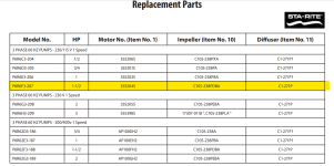

  • maxepro-series-pump-replacement-parts.pdf

This supplier replied to me and they can ship to the Philippines. This is the exact motor replacement therefore I decided to get from this supplier. Thank you so much for the big help.
