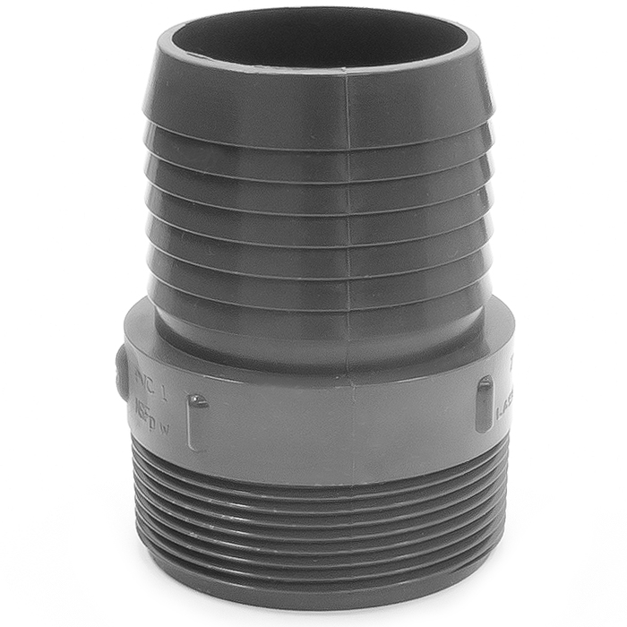

The piece in the picture is meant to connect 2 backwash hoses together with no pvc in between. I also have one that only has barbs on one end and the other end has threads to screw into a 1.5" pvc female threaded coupler. The other end of the coupler is slip fit so it should be glued to 1.5" pipe.
I just put one of these together today so I could connect my vacuum hose to my utility pump. I originally used a thin backwash hose, but that doesn't work great when the pump is sitting at the bottom of the deep end and the backwash hose has to come up several feet. Because the backwash hose is flimsy, it gets pinched quite easily and makes the job more difficult. A pool vacuum hose is much more rigid and works much better.

Buy a 2" fpt to 2" slip PVC adapter, so now your PVC has female threads, then buy a 2" male threaded Barb for your backwash hose
