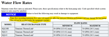

Below is what Aquacal says about Water Flow Rates.
At 3450 RPM your pump can do more than 70 GPM and thus damage the heater.
Be careful turning up the pump speed too high to get strong spa jet pressure while you have water flowing through the heater.
Your builder should have installed a flow gauge with the bypass valve so that you can manage the water flow rate through the heater. Consider adding a water flow gauge to your plumbing.
