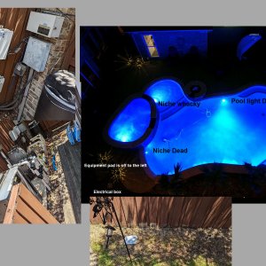

As I posted before our large pool light has gone out
All of the other lights go to junction boxes in the landscaping
I can't find the one for the pool light.
Any secrets from the experts here ? We can't justify / afford to pay a pro this year . And if we knew where the wires terminate it would be a relatively easy job

Unless the cord was long enough to reach back to the equipment pad, I'd say your junction box is within 15' of the light itself. It should be up out of the ground about 2 or 3 feet.
Are there any unknown switches at the equipment pad?
Is the light close enough that the switch could be on a Porch or an shed?
Reactions: DavidArmenB
There are 2 surface boxes I've found and a four Plex outlet that is just off the deck. It has connections for another outlet that is controlled by the system. I'm unable to find a circuit that is energized when the pool light is on.
The light is jandy led so it doesn't have replaceable bulb. I plan to change to that to make future repairs easier and cheaper .
Don't have a handy picture but I'll get one
Here is screenshot from a YouTube, very similar to what I have , but we have 2 rows of relays in 2 boxes like this.
And the wires on the relay are 120 volt and 12 or 14 guage , purple as I recall.
Google says the wires for a 129 volt jandy led from 5 years ago has stranded black white and green wires. Haven't been able to find them
Also posted a picture of one of our surface boxes that is at about the 4 o'clock position in the image in the lower dark edge . It has transformer for 3 sheer decents and connections for the led in the waterfall.
The 2 surface boxes on the edge nearest the pad makes me think they didn't home run it.

hope this is viewable - its a drone shot with an over view with close ups showing the details in the drone shot
here are some
Ill take some more
here is an album of all the images I have that might help
what else can i take pictures of ?

Your light cords are in this box, large cables.
