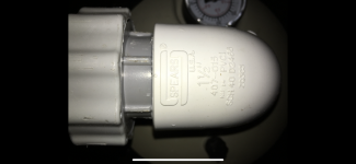

I had My intex pool hard plumbed except the flexible hoses. I used a Hayward Pump and Filter. If you post a picture of the connection you are trying to make I will try to help. All my intex stuff is gone as I am about to break ground on an in-ground pool. Here is the adapter you are already using on my Hayward Pump ….

I created my own as well in this photo. We were concerned with our small kids that the water level was too high, so we filled to pool about 2/3’s and then I created this adapter so that the return water coming from the pump to the pool was under water ….

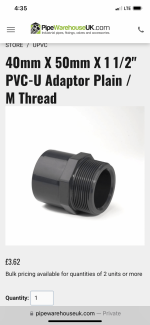

These items I found on the internet, looks like in the UK they have these adaptors …. Research on the TFP forums 40 mm female adapter for intex or Bestway pools. Someone has had to so this before ….

This second one appears to be exactly what I need, if I can find it in the US. Thank you, I will also follow up on your other links.
