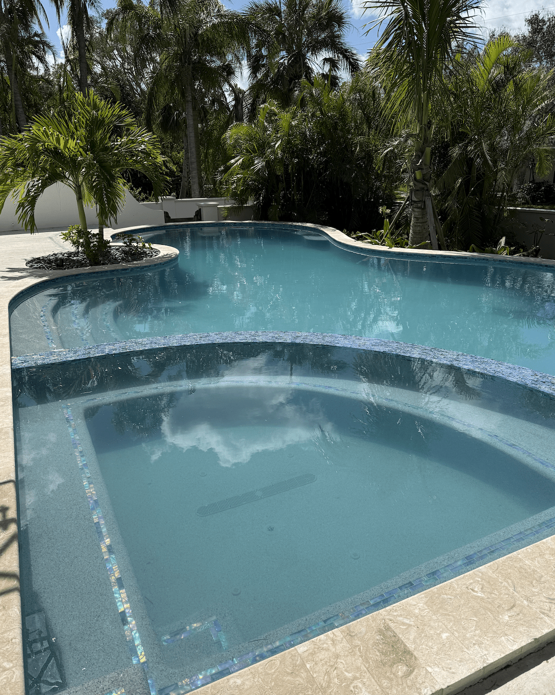

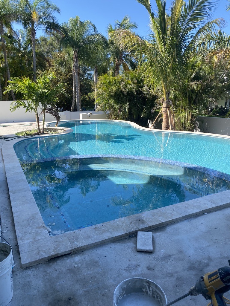

The whole pool is 16,300 gal including the spa. The spa has seating on 3 sides though, which that takes up volume. There is rougly 3.5 feet deep in the center and 20" depth from the seat to the waterline.
Show us pictures of your pool and spa design so we can see your situation.
I was wondering about that. The water is just over the spa edge. It is supposed be a little bit below the wall when in spa mode. We turned off the autofill to let the water dip below. I have been thinking there must be another line where water comes in because we had it off for 2 weeks and the water level barely moved. My husband said that he felt the water that was going into the spa and he said it didn't feel very hot, just maybe warm. So perhaps a valve isn't shutting all the way?
When you are in Pool Mode, does the spa spillover? How is that done? Take a picture of your equipment pad in Pool Mode. Then in Spa Mode. Concentrate on the return valves.
That spa design does not sufficiently isolate and insulate the spa from the pool.
I hate to be negative, but you have a fundamental design problem.
When I am in Spa Mode, the water is right at the wall. The pool water is about an inch below the spa. I'll post the videos. As far as the equipment, the valves are automated.
