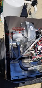

So just in case anyone comes across this thread researching the same issues, it seems it's fixed right now. I opened up the top of the unit to take a look at the vacuum hoses and three of them seemed to not be seated completely. Also an electrical connection on the vacuum pressure switch itself was not completely snapped down either.
So far the heater has been running fine after I did those few things. It ran for about 3hrs getting the temp up to 90 degrees and so far so good.

Let me know how it works out. I'm very curious about it. So far we have ran the heater several times, about 4-6hrs or so each time and so far no issue. I really hope that's all it was with the hoses. Don't forget to make sure those blade style electrical connections on the pressure switch are seated well and pushed all the way in too. One of mine was like half-way pushed on.
My heater would error out within an hour, so I was guessing it was an issue of heat building up just enough to move either one of those hoses or that electrical connection by a fraction to cause that error.
