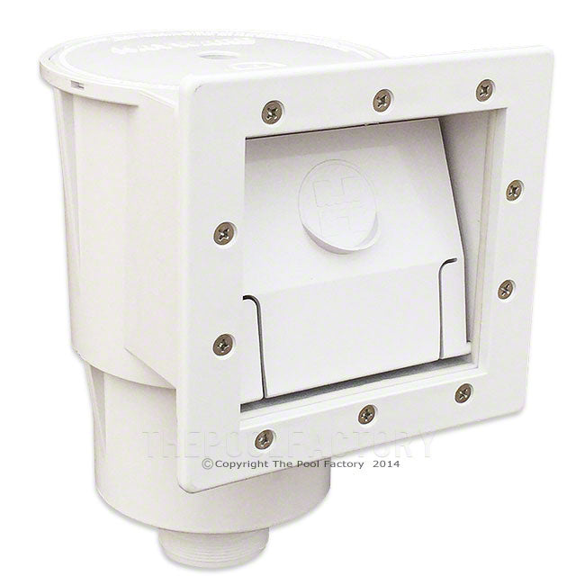

Planning on hard piping my intex pool with 2" pvc and want to use the larger connection on the bottom of the skimmer for better water flow.
It is larger than 2" PVC, obviously proprietary. Does anyone have a link to the union I need to go from their connect to 2" PVC?

I don't think they would use a proprietary connect there. Their skimmers need to be installable by plumbers with standard equipment.
Here is a picture of the 2" threaded coupling on top of the skimmer. As you can see the threads on the bottom of the skimmer are quite a bit larger than the ID of the 2" coupler.

Ah, I know it well. Somewhere in my thread about my new pool there is a link to the fitting that will likely work for you. But, it comes with a 1.5” insert, so you’d be reducing down to 1.5 anyway. I would simply use the inside threads on the bottom of skimmer where the hose barb screws in (the smooth bit you refer to) and pick up a threaded PVC connector. That’s what I intended to do before I discovered that installers glued the hose barb in. Yep, I’m still bitter.
That outside threaded bit is proprietary, but the inside threaded bit is standard - to be sure you have a good fit, take it with you!
