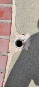

Here are some pictures of my sockets. The top would be easy for me to remove or repair, but the underwater one not so easy. I'm still thinking I would like to fill the in pool socket in and flatten it out. It feels nasty when stepped on. I don't mind buying a deck mounted rail that extends down to the bottom step. Like the figure 4 type.
Hard to tell, but the socket in the pool appears to just be missing the wedge-bolt assembly.
Perma Cast PW Perma-Socket Wedge Assy, 3", 4" Sockets
One on the deck shouldn't be too difficult to replace. Figure-4 rail would, obviously, need another anchor drilled into the deck. I always recommend Saftron as they stay cooler to the touch and don't need to be bonded as they are plastic coated.
