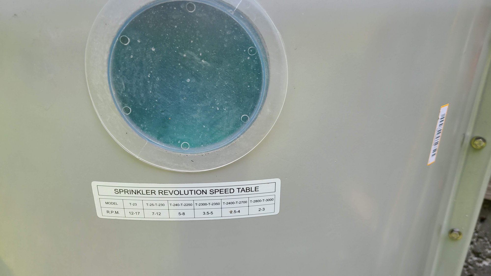

It should do far better than that. What is the RPM on your spray head? There is a big difference in the output of cold water based on spray head RPM.
@ 7 RPM the water from the chiller to the pool runs for 1 minute and 20 seconds with 40 seconds of downtime.
@ 12 RPM the water from the chiller to the pool runs for 2 minutes and 43 seconds with 32 seconds of downtime.
So huge difference in the volume of cold water being pumped into the pool.
@7-8 RPM it was taking 6 minutes to fill the lower tank!! The sump would run for 45 seconds or so to drop it back down.
My instructions said to set the spray wand to a walk speed or till its not spraying out the top. I got my sprayers up to about 28 RPM and at that speed it was not splashing out the sides or top and the sump was kicking on every 2-1/2 minutes and ran for just over 1 minute to drain it back down. The water is dropping about 5 deg from top to bottom no matter what speed i set it at. At the 28 rpm the water was also not being slung to the sides of the tank. At that speed it was still flowing onto the cooling media. The pool has heated up good today. It will probably hit 91-92 before the day is over so I'll run it tonight and see how it does. Our relative humidity isn't helping matter at all either.

I think you have a better handle on it. I measured my water temp top and bottom and while I can't remember I think it was more than 5 degrees.
I have mine plumbed into a single 1.5" return line. That line has an eyeball fitting in it. The full force of the chillers pump pushes water with the only restriction being the eyeball. If I take the eyeball out it empties the tank and just over a minute...but still refills in about 35 seconds. I don't know why it would take yours 2 1/2 minutes between pump runs, it could just be because of the different models of chillers.
I will say it's not an overnight fix to get your water where you want it. If the water is in the 90's....it may take a couple of days to get the "end of day" temp to a point where the chiller does not have as much to overcome during the nightly run. You may want to run it day/night for a couple of days to get it down. Is your chiller in the shade or full sun?
On my pool the chiller gets full shade all day and if I run mine during the daytime hours it will keep the pool to within 1-2 degrees of whatever the temp is at the time I turn it on. So lets say at noon the water has warmed to 86, if I turn it on a noon the water will never get warmer than 88...your mileage may vary.
I spoke to a Tech at Glacier yesterday. He said that my 2-1/2 minutes between cycles is good.
Because i had to plumb mine into the the skimmer and main drain he told me to cut the valve 1/2 off from them so it actually pulls more from the cooler return.
