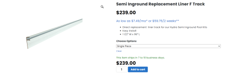

I saw a fiberglass pool that had been drained and they received a large rain which popped and cracked the bottom of the pool but didn't pop the pool out of the ground. They had a vinyl liner installed in it and it looked great. I was really surprised how well it looked. They attached the liner to a track that just left a small amount of the track exposed at the top but it pretty well blended in with the liner. The track was both taped and screw to the fiberglass shell. They put a small amount of sand in the bottom of the deep end to cover some of the fiberglass damage prior to installing the liner. You will just have to find a pool installer that willing to take the chance. They covered the main drain up and just used the skimmers.

Thanks for the feedback @sls. The more I research I am seeing it has been done. There is a company in Australia that advertises the service. Do you happen to know the track style they installed?
