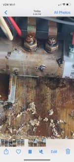

Ok guys went out pulled cover and the heater has water leaking.....actually shooting out in 2 different spots. I took a video but cant seem to upload it. so I took a couple screen shots. I unhooked the terminals and turned breaker on and it held for approximatly 30 seconds then tripped again. I am thinking there was enough moisture in there that that is why it tripped again. I am going to start with the heater because it is bad for sure. I will keep yall posted!

Guys I have ordered a new heater but I have been thinking about something. So when I took the nuts off the electrodes and turned the breaker back on...power only stayed on for about 30 seconds. I did this a couple of times and it seemed to trip quicker each time. The first time the display showed 68 and I figured that was the water temp but the last time it had 22 then went to 24 shown on the display panel just before it tripped. I had already shut the valves off on both sides of the heater. would no water in the heater cause the breaker to trip? Like I said before I know for sure the heater is bad and I am going to start with that but was just trying to figure out why the breaker was still tripping with the contractors removed from the electrodes.
No, you have another issue.
And I just have to say that you have one of the BEST examples of the results of bad water chemistry I have EVER seen in 26 years in this business. You corroded through 1/16 of an inch of stainless steel in multiple locations. That is NOT easy to do.
And given that fact, I am not surprised that you have other issues. I am amazed it ran before you drained it.

Sorry guys I just got back from a trip out of town. The new heater was supposed to arrive today but now tracking says tomorrow. Yes you are correct about the bad water chemistry. After having a heavy bathing load the water looked very cloudy. I turned my Saltron Mini up to 12 hours a day thinking I would only leave it there for a day or two.. Fast forward several weeks because I forgot about it and we do not use the tub that much in the summer months. when I did check the water, it looked and smelled like pure bleach.... That is why I drained and refilled the tub. I went out today and turned the breakers on with the heater terminals unhooked and the breakers seemed to hold now. The hot tub is about 15 years old. I got it from a friend for free last October and set it up and everything worked fine. so if it never works again I got my moneys worth....lol ;). I will install the new heater when it gets here and let you all know whats happening. I did look under the tub and inside the cabinet and do not see it leaking any where else. Fingers crossed that I can get it going again.....
Ok got the new heater today and installed it tonight...Good news. Everything is back up and running with no leaks. Salt level good and Saltron mini producing chlorine and heater light is on and heating water. I got really lucky because I am amazed at how much damage the bad water chemistry did due to my absent mind and negligence. I have attached some pictures of what very very high chlorine levels can do to stainless steel. I am amazed that everything is working again but I will not be surprised if I start having pump failures soon. Please do not make the same mistakes I did. I generally take good care of my pool but i did neglect and forget about my spa because I do not use it much in the summer. I will never make this mistake again :brickwall: The good news is the pool still looks awesome thanks to T.F.P. !!!! I had to put one photo of how good the pool looks..
