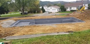

Did they put in a sump pit? I hope they did because the warranty will be voided without it. If they didn't, one will need to be installed outside of the deep end corner of your choosing. I believe I have seen this build on my group Imagine Pools and Landscaping. I'm actually glad to see you made your way here. We can assist you better at finishing your pool here. You have the know how to do the plumbing and electrical and it can be a weekend project. Make sure you have some ibuprofen available. If I were closer, I would certainly help you manually but Alabama is a long ways from Pittsburgh Pa. I sent you a response to your pm. I also took your pic n added the placements of my returns n lights. Returns are on the left and lights on the right. I have 3 lights. Skimmer in middle of deepend. I agree that those need cut out before you move forward.

Here is the placement of my returns and the lights. Returns are on the left side of pool looking down towards deepend and lights are on the right. I get great circulation with this set up. The fact that I have 2 returns on the tanning ledge prevents stagnant/standing water. You can also see the bow in my long wall. I suspect yours is more significant because it's sat unfinished with water that's gotten a little higher than backfill.
FB_IMG_1697893355162.jpgFB_IMG_1697893373420.jpgScreenshot_20231021_090323_Facebook.jpg
