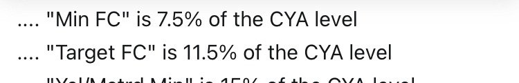

You want to be in target fc range for your cya
FC/CYA Levels.
