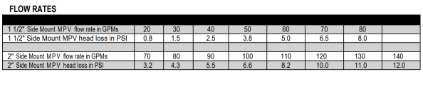

Also, be aware that the MPV is more restrictive when compared to a push-pull.
The head loss is only slightly lower for the slide valve.
H = 0.00140800F^2 for slide valve.
H = 0.00147840F^2 for the multiport.
The multiport is only about 5% more restrictive than the slide valve.

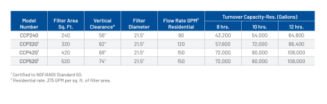

My current filter is a 48 sq ft DE, if I went with a Cartridge filter, something like a Pentair 420 should do the trick right?

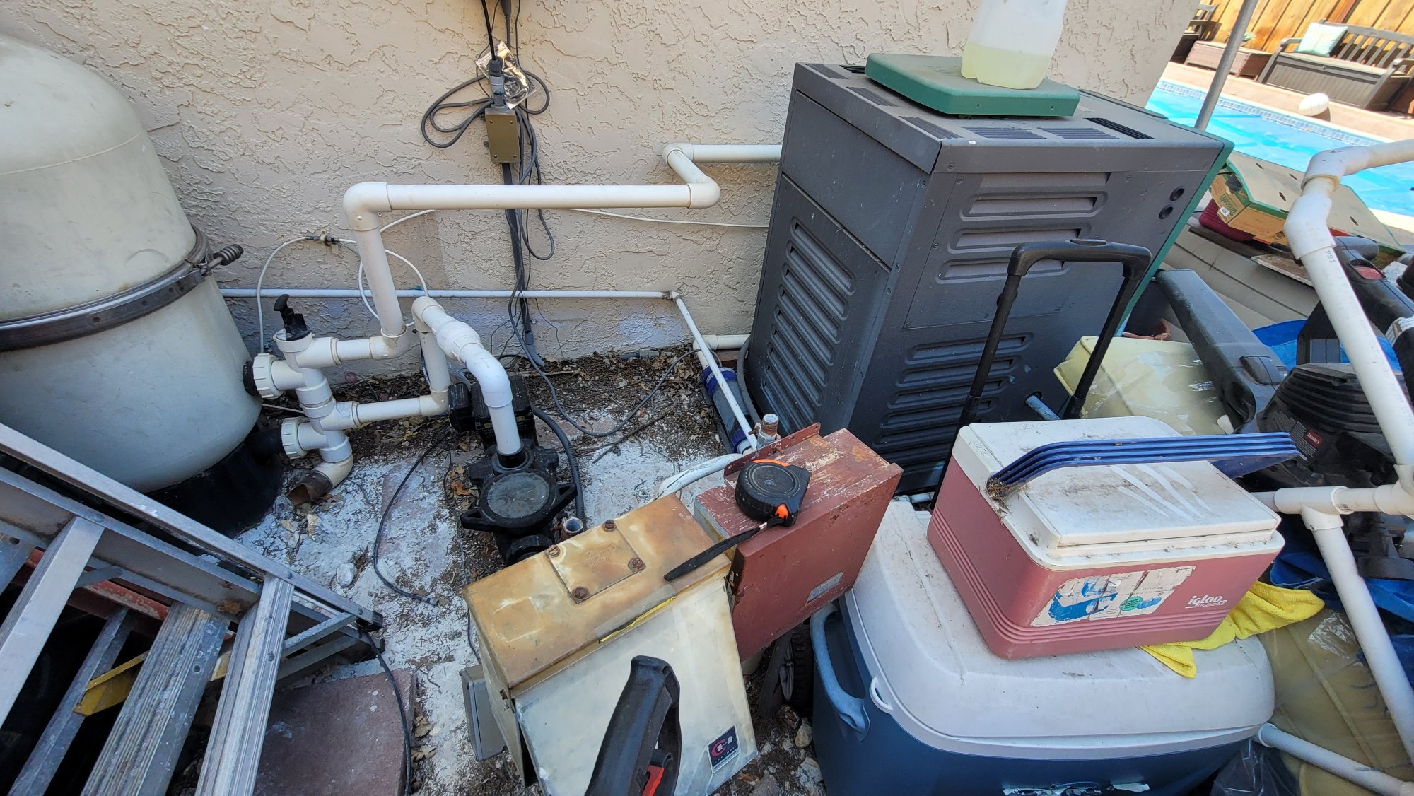

The other problem I have is the 1.5" plumbing, nothing I can do about that but just wanted to point it out.
That would be great for you. If sticking with DE, upsize it accordingly. (60? I think).
No issues. Either reduce the 2 inch fittings at the filter, or replace the pad plumbing with 2 inch. Either way you won't see an appreciable change. If you're already out there cutting and gluing, nows also the time to straighten anything out that needs redoing. Whether it's defunct equipment like an old tab feeder or ancient valves, it would suck to be back out there next season doing it again.
