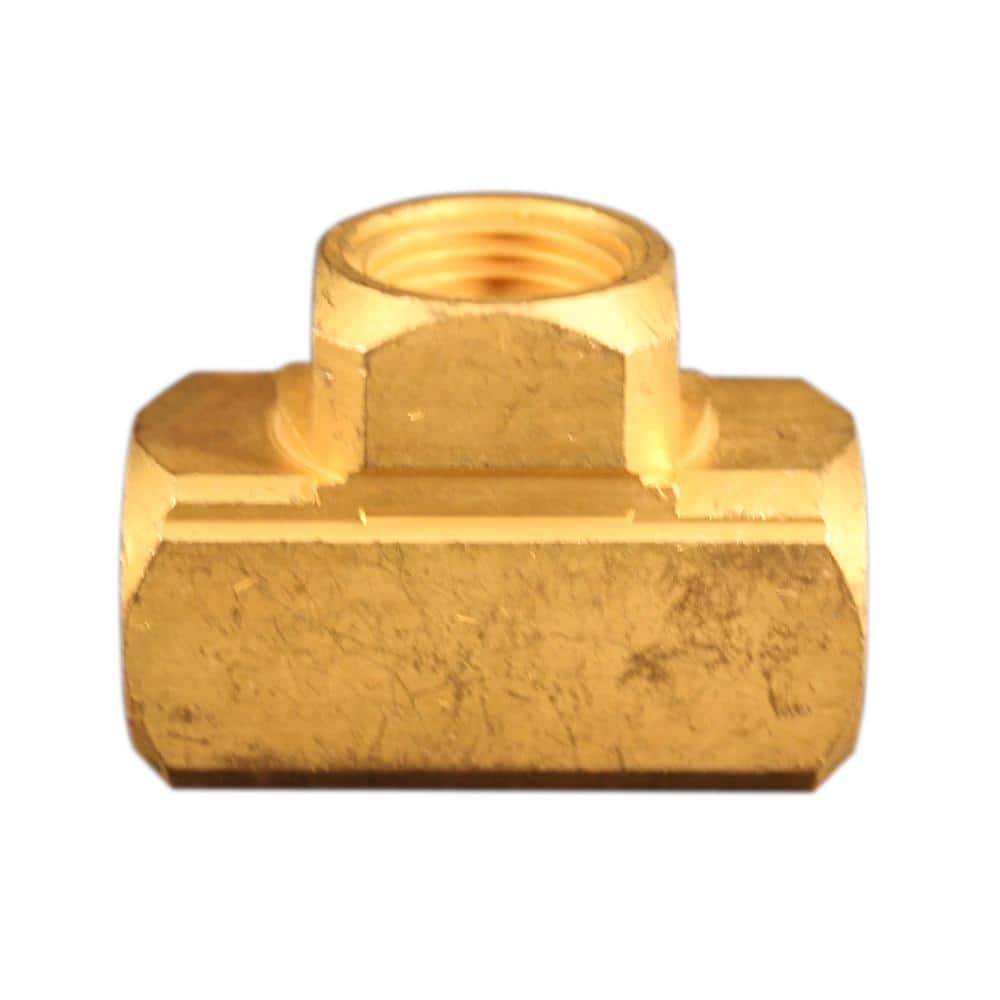

Is this what you have?
What part is broken?
Yes. That it. The T part is what broke. I called Leslie’s Pool Supple and they are out if stock and 2-4 weeks to order. I ordered one on Amazon which will take about a week. But this morning I woke up to a green pool, so I just want an emergency plug to be able to run my pump.
BTW. My pressure gauge is so yellow I can barely see through it. I ordered all OEM part to replace the entire assembly as well as the filters. As I do more research I think I should just upgrade to better parts...higher flow relieve valve and retrofit the filter to the 3 smaller ones.
All that can be replaced later. For now I just want to get everything running ASAP and will return what I don’t use/need later.
I believe you can remove the T part and screw the gauge directly into the other black part. You won't have a bleed off unless you unscrew the gauge till liquid begins to flow and hen screw it back in till air stops coming through the threads.
Get these two parts and you are back in business.
