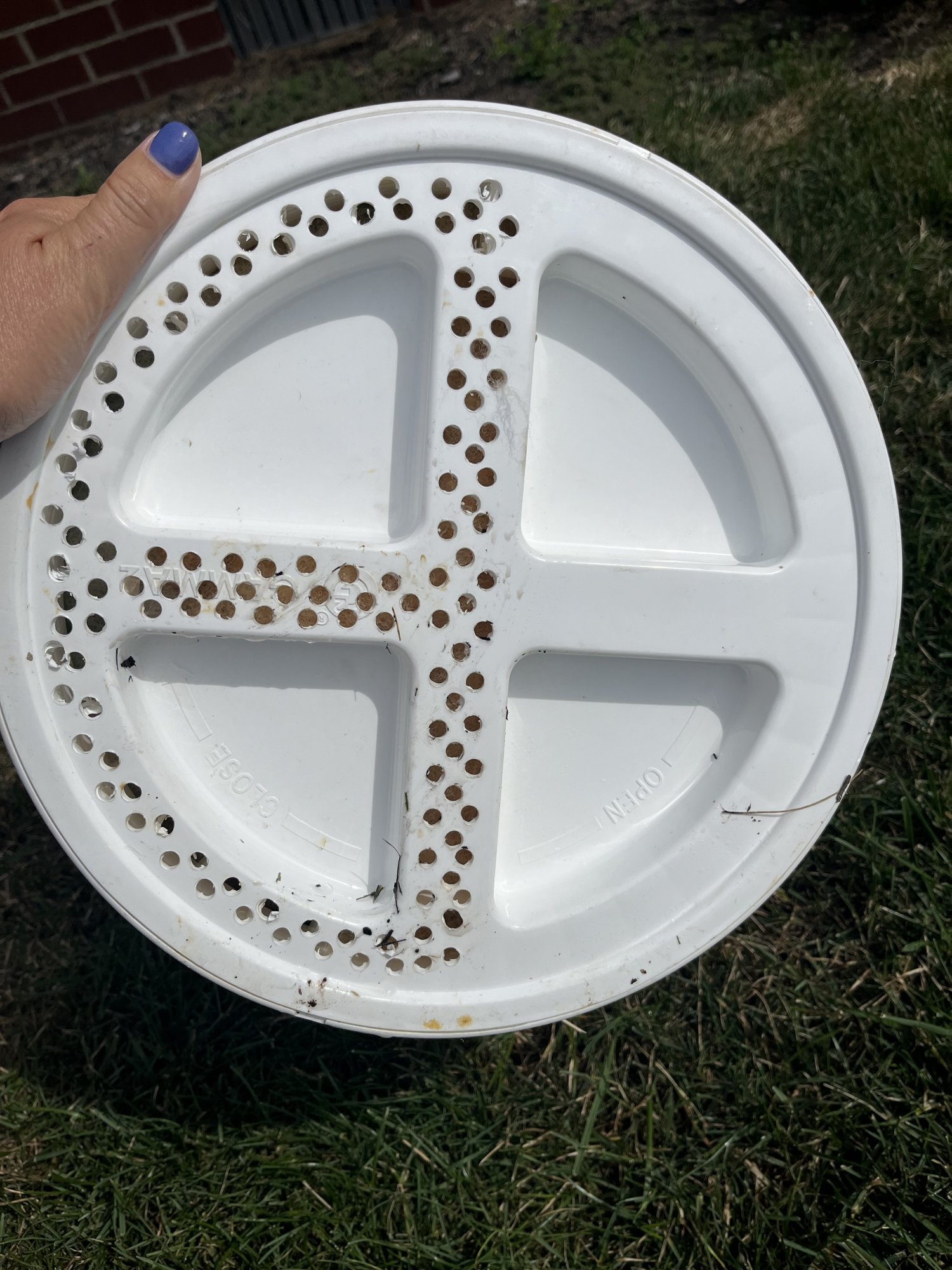

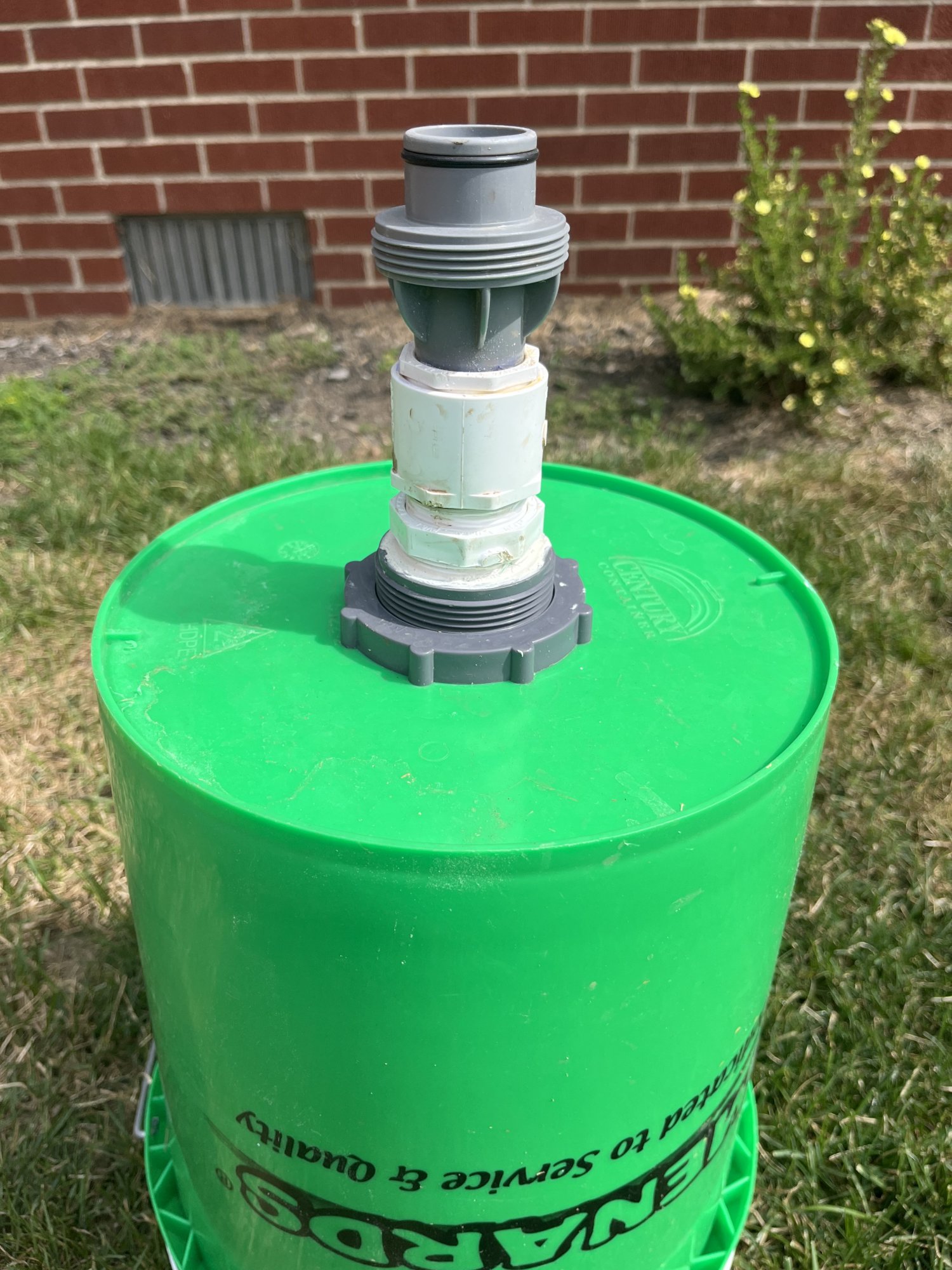

Are you able to rig something up that resembles this?
The sad news - filtering from the hose isn't effective. Iron can exist in the water and not be caught... BUT once it comes into contact with your chlorine, it oxidizes and attaches to the polyfil in the bucket (you'll have pillow fluff that resembles orange cotton candy when it's all said and done).

We're going to want to disconnect that hose from the pool and use it to funnel your pool water through your filtration; then through a 5 Gallon bucket with Polyfil, back into your pool.
Polyfil bucket ingredients:
  • 5 Gallon Bucket with a SCREW TOP LID (ask me how I know you want a screw top lid, after you chase polyfil in your pool at 10 PM)
  • A method of drilling a hole with the same size fitting as your return hose
  • A second method of drilling holes in the lid of the bucket
  • 3-4 cheapie pillows (I recommend the $3 variety at walmart - something you're not afraid to throw away)
  • An excellent sense of humor 💪
