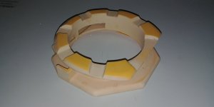

I’ll assume you’ve watched this -
Looks like there’s a couple of internal components that can be replaced for a rebuild.

I have not seen that, thanks. At the 6:00 mark he says something about a compression ring, but even with my sound turned to 100%, I could not understand him. Sound quality is very poor!
OTOH, I've got it trucking around just fine for now. I guess with worn internal parts, valve (suction) adjustment becomes more critical...

Yeah. It sounds like the internal compression ring can become worn out and that it can be replaced. You ought just look online for G3 rebuild kits and see what’s offered for rebuild parts.
