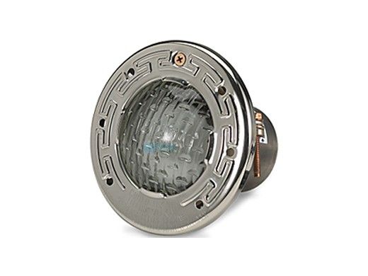

Can’t seem to find a replacement fixture for my American Products light fixture P/N 98708400. My current one somehow burned a hole through the casing and I need to replace it. Anyone have a current part number that would work? Thanks!

Should be a standard Amerilite, now owned by Pentair. If yours has the heavy chrome-plated face ring it is the older version. If it is the smaller light, about 7" in diameter it is the Spabrite.
Thanks! Can you clarify how I should check to know which version I have and what would be the correct replacement?
First one - Amerilite, large full-size pool light.

Second one - SpaBrite spa-size light.
You also need to know the length of the cord to get from the light to the j-box plus some wrapped around the light so that it can be serviced.

Perfect thank you! It’s the second one that I have— SpaBrite.
