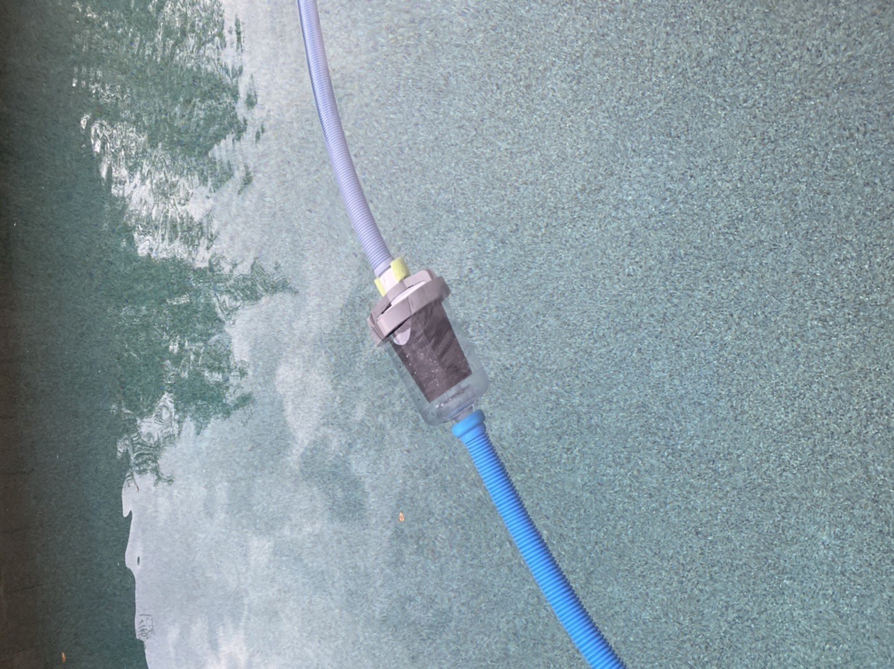

You have to be careful with the big canisters because they have a tendency to sink. I included a Pentair hose weight on one end and a chopped up section of pool noodle on the other end to keep the leaf trap at the perfect orientation on the pool surface -
I didn't realize they need to stay at a specific orientation? Don't you want to flood them so there's no air inside? When you do that they sink, but, stay fairly level with the alignment of the hoses?
I have never had an issue with them floating with a small air bubble inside. My canisters have always done that to a certain extent and it's never affected the performance of the cleaner. However, when they are completely full and sink downwards, they put more stress on the hoses and can interfere with the movement of the cleaner. So whether or not they are full or have a bubble, I always have had my canister at the surface so that the cleaner can move about freely. Putting a float on the front and a slight weight on the back pitches them the optimal way for my setup.
