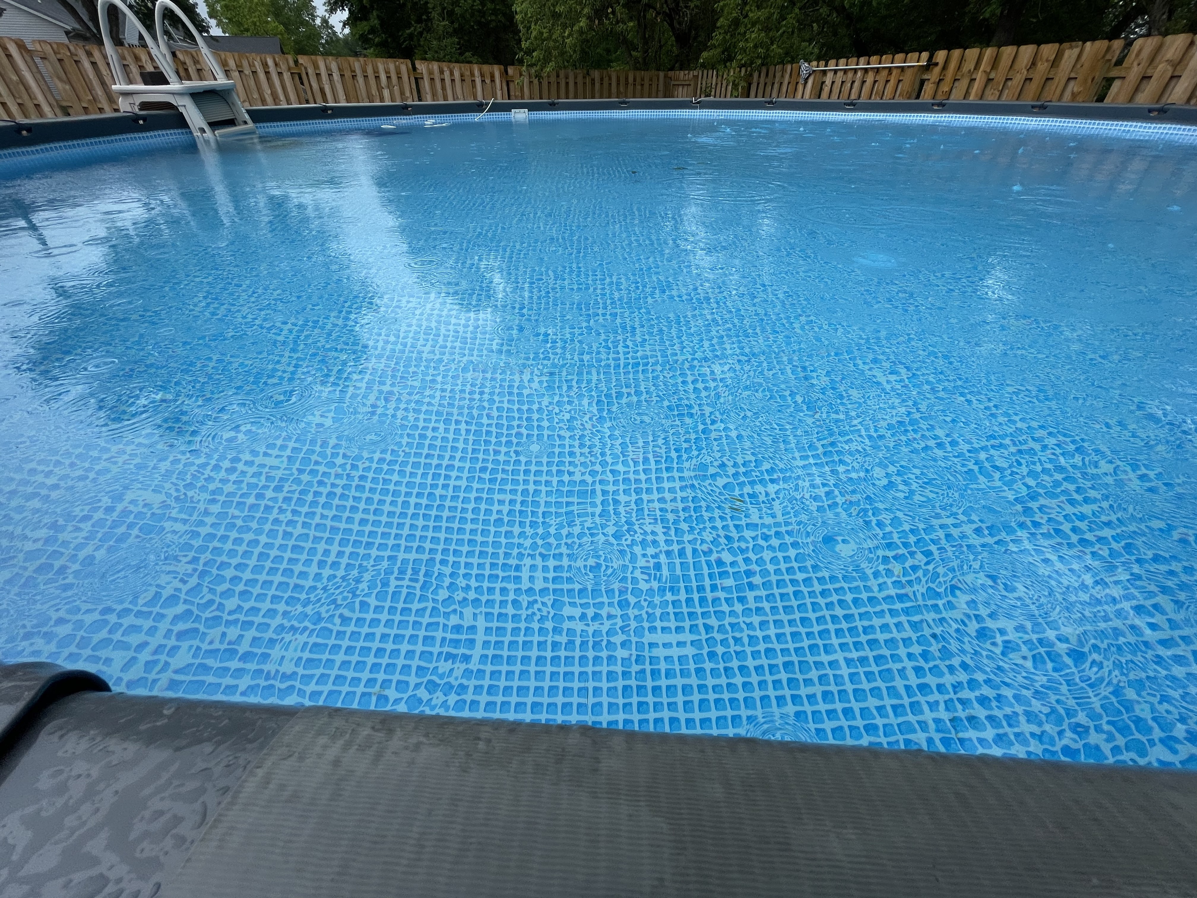

That is not what I said at all. Here is my pool as of right now, on this rainy Saturday. Crystal clear.
Or on March 28th:
August 3rd, 2020:
July 17th, 2020:
Except for at the start of this year after the winter, my pool has always been crystal clear and trouble free. Trouble free doesn't mean maintenance free. No matter what you have there isn't a pool yet that you can hand over to some technology and have everything be perfect and trouble free.
