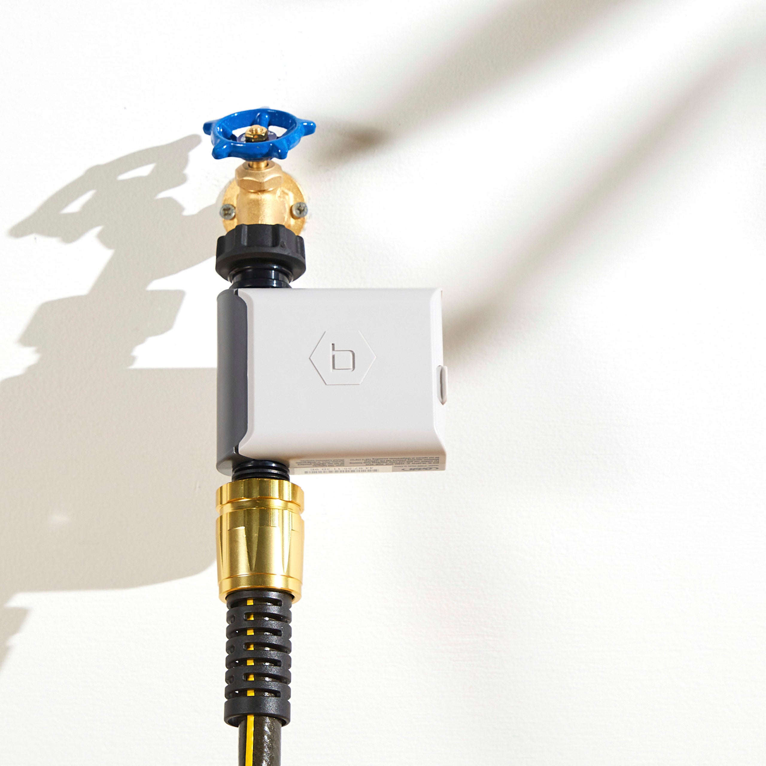

You could use one of any number of simple inline watering timers, attached to the faucet, but you'd want to make sure the one you choose has some sort of anti-siphon feature.
Orbit 62061Z Single-Outlet Hose Watering Timer, 1, Green
If if doesn't then add an anti-siphon mechanism after the timer. This is a cheap one.

If you look around, there are probably wifi-enabled sprinkler timers. There are limitless ways to go to automate your current fill line.
Dirk, thanks a lot for the suggestions. I tried the 2nd option (without anti-siphon feature) before. The only drawback is that I can not remotely control it with wifi. I will do some research on the first option.
