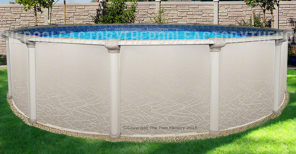

I am looking to upgrade our intex ultra 20x48 not after 3 years a pole has rusted significantly compromising the structural integrity.
Here is the pool I am looking at

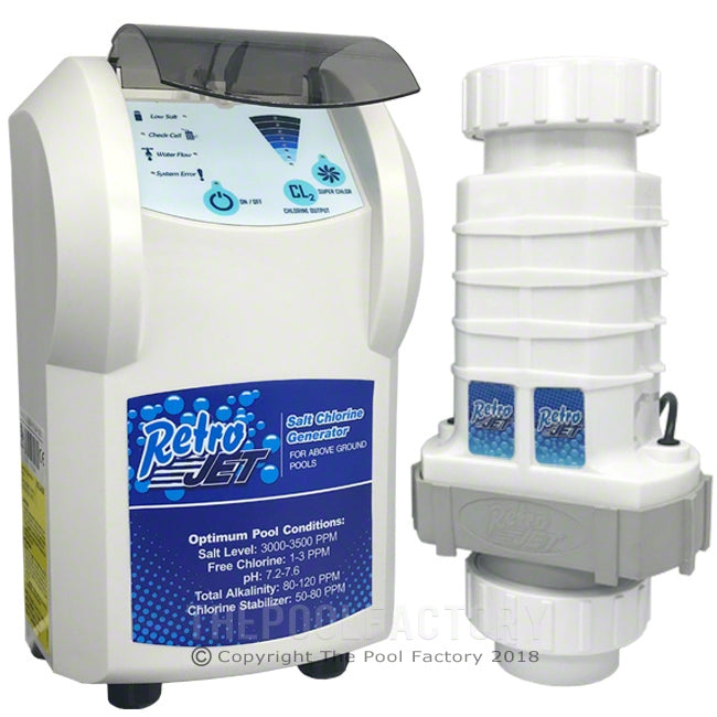

The main question is that salt water generator is rated at 20000 gallons when my pool would be 17000 gallons. From research it seems too small even though the company is confident that this will work fine. I have never had a salt water pool so dont want to screw this up especially when it will all be new.
For 300 additional I can upgrade to this but this is only rated at 25k gallons

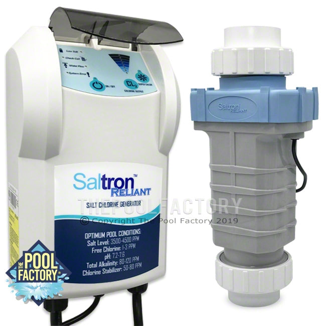

for 400 additional I can upgrade to this which is almost double at 30k gallons for 400 more.
www.thepoolfactory.com
Should I spent the additional 400 and get the 30k gallon model?
27'x52
Saltwater 5000 Round Pool is one of our best above ground pools. It includes a skimmer, blue liner & service panel for superior corrosion protection.
