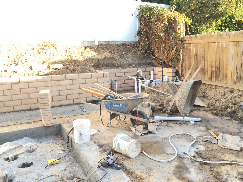

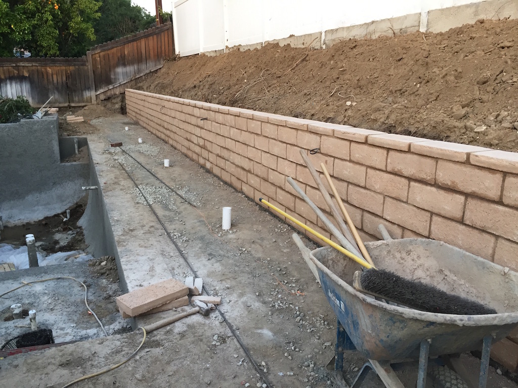

Ive started my Owner Builder pool here in Southern California. It's just my wife and I (no kids) so this is an adult pool. My wife wanted a "shoebox" so that is what we've designed. The pool ends up being 12' wide and 30' long (10,500 gal), 6 feet of Baja deck with bubblers and a 6'x6' raised spa with spillway and 10 jets. All the equipment is Jandy with SWG and their Versa-Plumb piping kit, Im doing an in floor cleaning system and Jandy RS/PS4 with the iPhone interface. I've included an allowance for a Pebble Tec type finish. Ive carved an 8x8' cutout in my small hill adjacent to the pool and will be building a CMU (concrete block) enclosure for the equipment, hopefully it cuts down on the noise. Coping will be poured in place cool deck.

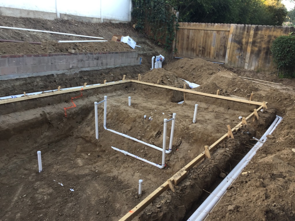

My excavation guy was well equipped. 3 dump trucks, 2 Bobcats and a backhoe for a 12x30 pool.
Plumber is coming Monday....

NICE job so far! Have you measured everything to make sure it is deep enough, wide enough, long enough, etc. Add in about 3 inches for gunite and plaster.

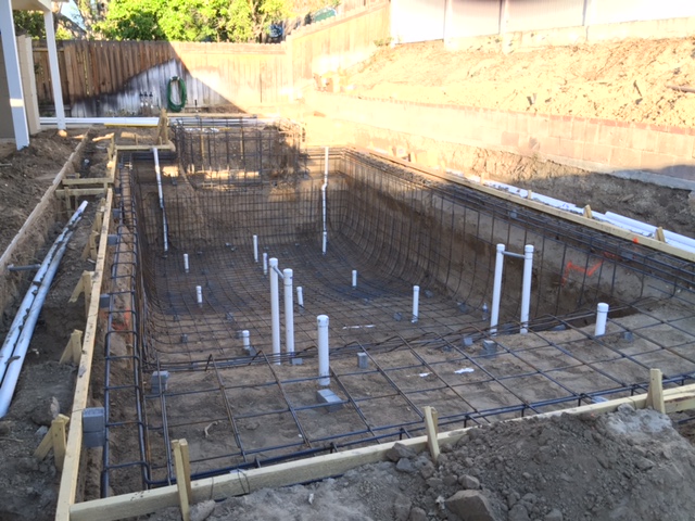

I have to recind my comments about LA City DBS inspection. It turns out that the inspector was correct and the Engineer did not take into account the "surcharge" of the hill "immediately adjacent" to my pool. Per the correction notice, I hired a geologist who confirmed the problem - so went back to the pool engineering company and asked why it was not designed correctly. They missed it and reengineered the steel specs. I called the steel guy back out and they had to remove a bunch of the 3/8" rebar and replace it with 1/2". While this was going on, we had a couple of really good bouts of rain that washed all the muck into the deep end and pretty much buried the rebar.
So it all worked out well for me. When they pulled the old rebar out, it gave great access to remove the loose fill and muck to be removed:
rebar removed -
Cleaning out the bottom:
New rebar installed (1/2" on 3" centers!!)

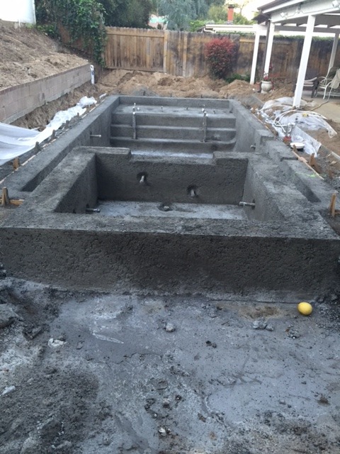

Keep in mind there is 12" of 3000psi shot crete on top of this..
Next is cement installation!
