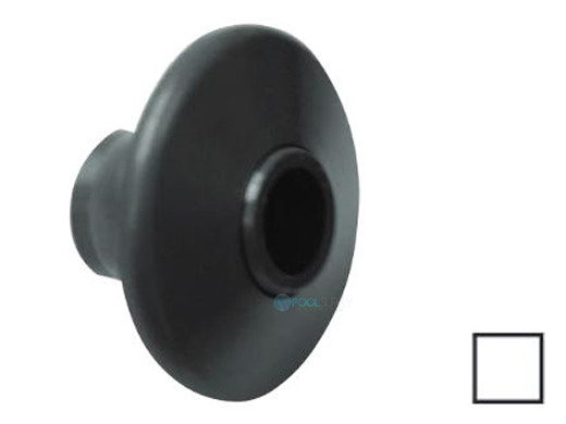

This looks like the same return fittings you have. It shows 1" inside slip/knock in:
Here is the manufacturer's page. Take a look at the spec sheet for measurements.
Awesome! Thank you! Guess I just wasn't looking hard enough or in the right places. Can't beat that price either!
